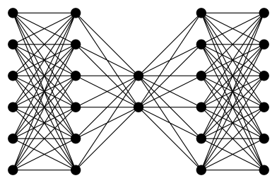

What about such a graph:
$\hspace{50pt}$example

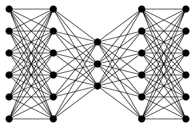

You could easily also make it 3-vertex connected, but not 4-vertex connected in the same way, etc.

dtldarek

  • Thanks for your help here, but i'm not sure about this graph because i can quickly find two vertices for which there are at least 3 vertex disjoint paths between them... this would make the graph 3 vertex connected would it not? I am referring to the first graph which you say is not 3 vertex connected – user3355894 Feb 26 '14 at 17:56
  • @user3355894 If you remove the two middle vertices, then the graph becomes disconnected, and so it is not 3-vertex connected. – dtldarek Feb 26 '14 at 17:59
