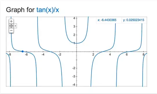

If you plot $(\tan x)/x$, e.g. by typing "(tan x)/x" into Google or Wolfram Alpha, you'll see a plot like this (the below is from Google):
Plot of tan x/x
So you can see clearly that $\frac{\tan x}{x}$ has no limit as $x \to \infty$, nor does it diverge to $\pm \infty$, as it oscillates. Indeed it infinitely often takes the value $0$ (for $x = k\pi$ for integers $k$) and infinitely often approaches $\pm \infty$ (for $x$ around $k\pi \pm \pi/2$ for integers $k$).
