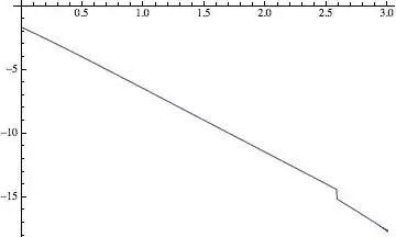

As an example, if we compare the remainder sum as a function of $N$ with the three-term sum above in a log-log plot as follows:
we see that the slope is $-5$, meaning that the next nonzero term in the series is $O(1/N^5)$, not $1/N^4$ as one might expect. The reason for this is that $B_3=0$. Note also the noise for very high values of $N$, as we have run against some machine precision for this calculation.
