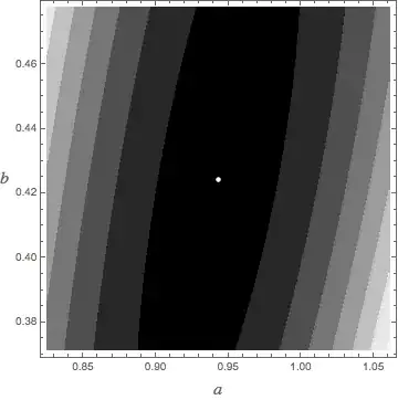

The least squares solution described in $(1)$ is $$ (a,b)_{LS} = \left( 0.943281, 0.424359 \right) $$ with total error of $r^{2} = 0.0143$
The solution point is displayed against a contour plot of the merit function in $(1)$. The least squares solution is nestled in at the very least of the total error.

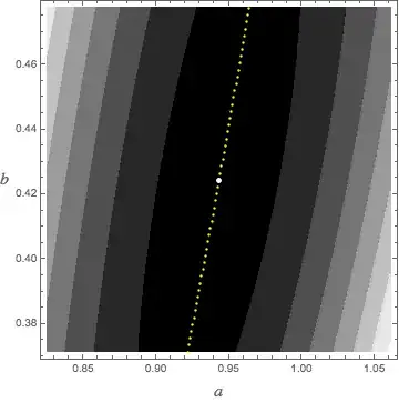

Go back to equation (1), and attack with the conventional tools from the calculus. Demand the derivative with respect to $a$ be $0$ $$ \frac{\partial} {\partial a} \sum_{k=1}^{m} \left( y_{k} - a x^{b}_{k} \right)^{2} = -2 \sum_{k=1}^{m} \left( y_{k} - a x^{b}_{k} \right)x^{b}_{k} = 0 $$ This produces a constrained version of the parameter $$ a_{*}(b) = \frac{\sum y_{k}x^{b}_{k}} {\sum x^{2b}_{k}} $$ Given $b_{LS}$, we can compute $a_{LS}$ like so $$ a_{LS} = a_{*} \left( b_{LS} \right) \tag{3} $$ The figure below plots $a_{*}(b)$ from $(3)$ as a dashed line against the full two dimensional merit function.
dash
Instead of searching in two dimensions, the problem involves searching along this trajectory.
line

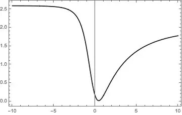

The constrained merit function is $$ M_{*}(b) = M\left( a_{*}(b), b \right) = \sum_{k=1}^{m} \left( y_{k} - a_{*} x^{b}_{k} \right)^{2} = \sum_{k=1}^{m} \left( y_{k} - \frac{\sum y_{k}x^{b}_{k}} {\sum x^{2b}_{k}} x^{b}_{k} \right)^{2} \tag{4} $$
The function is a delight to minimize. It has a lone minimum and is monotonic is the best way. Moving from left to right, the function decreases monotonically up to the minimum, and then increases monotonically.
Find $b_{LS}$ by finding the minimum of the $(4)$, use $(3)$ to compute $a_{LS}$. This exactly matches the full least squares solution and minimum error.
