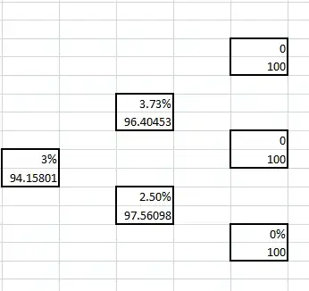

I would like to calibrate a interest rate tree using the optimization tool in matlab. Need some guidance on doing it.
The interest rate tree looks like this:
How it works:
3.73% = 2.5%*exp(2*0.2)
96.40453 = (0.5*100 + 0.5*100)/(1+3.73%)
94.15801 = (0.5*96.40453+ 0.5*97.56098)/(1+2.50%)
The value of 2.5% is arbitrary and the upper node is obtained by multiplying with an exponential of 2*volatility(here it is 20%).
I need to optimize the problem by varying different values for the lower node.
How do I do this optimization in Matlab?

  • Can you write out the exact formulation of the optimization problem? It should look something like $\min_x f(x) ,, \mathrm{s.t.} ,, g(x) \lt 0$, or something similar. – AnonSubmitter85 Feb 07 '14 at 19:19
  • how do you do that? I am not sure how to do that? I need the cell InterestTree{1}(1,2) = actualvalue(in this case:93.7129). I don't want to minimize but want it to be equal. Need some guidance on this.. – lakshmen Feb 07 '14 at 19:43
  • If you want them to be equal, then you can minimize their absolute difference. For instance, the trivial problem $\min_x \vert y-x \vert$ has the solution $x=y$. – AnonSubmitter85 Feb 07 '14 at 19:59
  • I will write the code for the optimization and post it tmr and reply when I am done.Can help to check whether it is right? – lakshmen Feb 07 '14 at 21:02
  • @AnonSubmitter85 I have written the function for the interestratetree.. How do u optimize the function that u have written? Need some guidance on that. – lakshmen Feb 07 '14 at 22:00
I think you're close. I am assuming that your goal is to find the values of InterestTree such that some function of it is equal to actualValue. (You really need to include this information in your question. Remember that I, or anybody else here, know nothing about the problem other than what you have written. You need to be explicit in what it is you are trying to do. You are much more likely to get effective help that way.)
The first step is to define your cost function. Let $\mathbf{x}$ be InterestTree and let $f(\mathbf{x})$ be the function that returns the value InterestTree{1}(1,2). Lastly, let $\beta$ be actualValue. We want to find $\mathbf{x}$ such that $f(\mathbf{x}) = \beta$. The error for any estimate of $\mathbf{x}$ will then be $\epsilon(\mathbf{x}) = \vert f(\mathbf{x}) - \beta \vert$. However, the absolute value function is not convex and convexity is a desirable property of cost functions (you can look this up or just trust me). Thus, we will usually want to use the squared error as the cost function. That is, we want to solve
$$ \min_{\mathbf{x}} \vert f(\mathbf{x}) - \beta \vert^2. $$
So you'll want to change the value of diff to
diff = (InterestTree{1}(1,2) - actualValue)^2;
To solve this problem in Matlab requires that we write a function that will return the value of the cost function given a vector. Thus, you will need to rewrite your ITree function so that InterestTree is a vector and not a cell array. Once you have done that, define a function handle that you can pass to the optimizer:
fhand = @(x)ITree(x, alpha, actualValue, volatility);
We are only searching over x, so that is the only variable that the optimizer needs to know about. The above function handle lets the optimizer estimate a value for the interest tree (x in the above) and get the cost function with fhand(x). Once you have defined this function handle, that last step is to choose an initial estimate of the vector that represents interest tree, x0, and carry out the optimization. Two built-in optimizers you can try are
x_optimal = fminunc(fhand, x0);
or
x_optimal = fminsearch(fhand, x0);
There are other optimizaers, but start with these and see if they will solve this problem.
