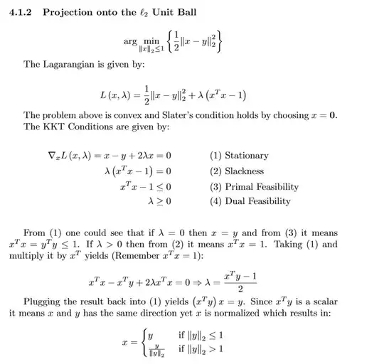

You can do it using KKT Conditions.
Here is something I wrote once doing so (Solution to Home Work exercise I had):
I wrote MATLAB code which implements them both at Mathematics StackExchange Question 2338491 - GitHub.
There is a test which compares the result to a reference calculated by CVX.
Royi
  • 8,711
  • can you give a hint for a projection onto a ball around some point $c$ with radius r? I thought maybe setting the function to be $min(||y-x-c||_2^2:||y-c||\leq r)$ – convxy Jun 08 '20 at 17:24
  • If you look on the code it supports any radius $ r $. Shifting is no issue. Remove the shift form the input, project and them return it to the output. – Royi Jun 08 '20 at 19:36
  • How do you conclude that $x$ is normalized and $y$ must be divided by $|y|_2$? Basically how from the fact that $y$ is a scaled version of $x$, you go to $\frac{y}{|y|_2}$? – DontWorry Nov 28 '23 at 17:03
  • @DontWorry, They have the same direction and you need to to do the least distance. So it must be on the envelope of the ball. – Royi Nov 28 '23 at 20:55
