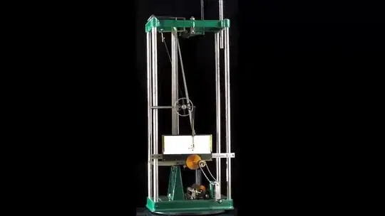

My answer is not about real world application, but about a real mechanical machine that was capable of graphing Fourier Transforms. In both senses, analysing and synthetizing a signal.
Harmonic Analyzer Mechanical Fourier Computer | Hackaday
I was amazed to discover it, and it was exactly on 2017/14/3, which is the $\pi$ day!
The video playlist explains it detailed and there is even a book Albert Michelson’s Harmonic Analyzer for sale Albert Michelson's Harmonic Analyzer: A Visual Tour of a Nineteenth Century Machine that Performs Fourier Analysis about it.
I also discovered there is an instructables project on http://www.instructables.com/id/Plywood-Math-Machine/ about building one
- 250
