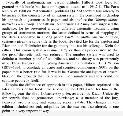

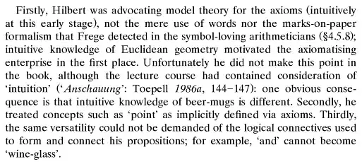

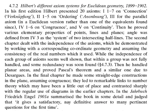

Edit: (T.B.) The relevant section 4.7.2 on pages 208–209 from Grattan-Guiness's book (taken from Google Books):
Grattan-Guinness, p.208i Grattan-Guinness, p.208ii Grattan-Guinness, p.209i Grattan-Guinness, p.209ii

  • Excellent...is the Grattan-Guinness mention on-line? – Mitch Aug 10 '11 at 15:39
    I took the liberty of including the relevant passage from Google Books. If you have qualms about copyright issues, feel free to roll back. @Mitch: see edit. – t.b. Aug 10 '11 at 16:56
  • The second paragraph is the most relevant...I really don't know how to evaluate its last line though: "This famous result is normally misunderstood and Hilbert may not have thought it though at the time". How -is- it supposed to be understood, and in what way was it misunderstood, and which way did Hilbert think of it? I thought it was a statement that labels for types are arbitrary and that the axioms provide the meaning. Is that the misunderstanding? – Mitch Aug 10 '11 at 17:49

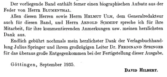

Added: I should have pointed out that Hilbert wrote the preface of his collected works. The end of the one of the third volume is displayed in this picture:
Excerpt preface
While I don't know what one is allowed to conclude from this alone, one might interpret the first sentence displayed here combined with the fact that it was printed in his collected works as an endorsement of the Lebensgeschichte.

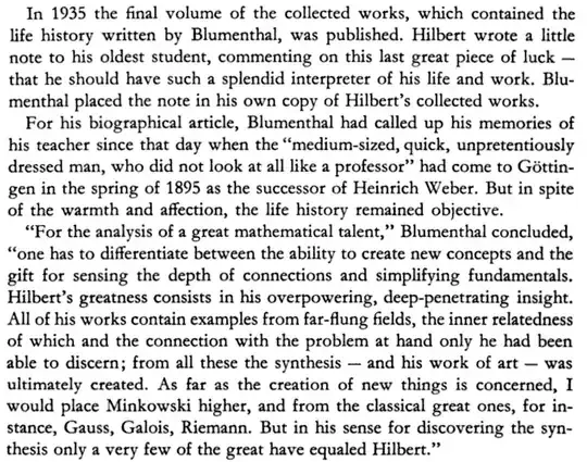

On page 208 of Constance Reid's Hilbert one finds the following passage supporting this view:
Excerpt from Reid's biography

  • Excellent answer..thanks for the scholarship. I imagined it would have been in Reid's but it looks like all she does is -use- that phrase rather than ascribing any kind of quote. With respect to your addenda, are you trying to say that Blumenthal was most likely not making it up himself but reporting what he thought Hilbert had said? – Mitch Aug 10 '11 at 15:47
  • I'm not sure what to make of that excerpt from Reid, honestly. I interpreted Reid's report on that note as sort of indirect speech (indeed, I think that H. must have written something of that kind, otherwise that line doesn't make much sense to me, as H. was to live about 7 more years). Concerning the train-station incident: It must be a second hand report because Blumenthal was born in Frankfurt and remained there until his Abitur in 1894. He first saw Hilbert in 1895 when the latter arrived in Göttingen from his position in Königsberg (see the section starting on p.399 of the Lebenslauf). – t.b. Aug 10 '11 at 16:35
  • Where was I getting at? It seems to me a bit too much to conclude that Hilbert endorses that small and rather trivial part of this lengthy Lebenslauf, but he must have been happy with the overall account. If that story were a blatant falsehood or to his disliking, he would have objected, I believe. I can't substantiate this more at the moment. Here's an online archive containing an interesting biography of Blumenthal by Felsch, by the way but the Biography of Hilbert is only mentioned in passing. Most sources there are not available online. – t.b. Aug 10 '11 at 16:39
