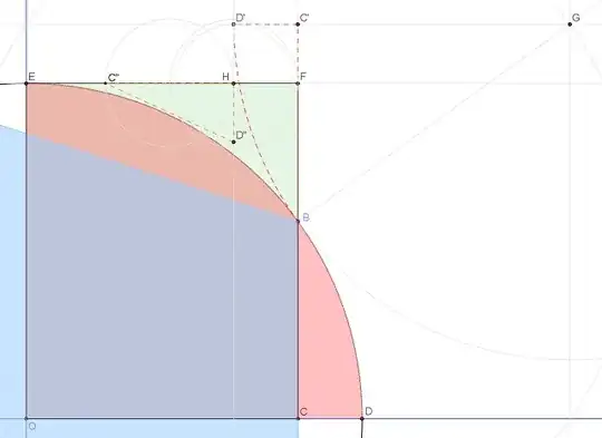

Phi vs Pi Inequality
Start with a circle centered at $O$ with radius $2$. Inscribe a regular pentagon inside it. Let $AB$ be an edge of the pentagon and $C$ be its mid-point. Extend $OC$ until it hit the circle at $D$. Construct a line through $O$ perpendicular to $OC$ and let it hit the circle at $E$. Let $F$ be the point so that $OCFE$ forms a rectangle.
From elementary geometry, we know the area of rectangle $OCFE$ is $1 + \sqrt{5}$ and the area of the quarter circle (the red one as shown) $ODE$ is $\pi$. To prove the inequality $1 + \sqrt{5} > \pi$, one just suffices to show the area of the green shape $BFE$ above is larger than that of the shape $BCD$.
Extend $OB$ to the point $G$ where $BG = OB = 2$. Construct a line through $G$ parallel to $OD$. Let $C'$ be its intersection with the line $CF$. Let $D'$ be a point on the line at a distance $2$ from $G$. By symmetry, the shape $BC'D'$ enclosed by the red dashed lines
has the same area as the shape $BCD$.
Construct a line through $D'$ parallel to $OE$ and let it hit the line $EF$ at $H$. The area of that portion of the shape $BC'D'$ outside the rectangle $OCFE$ is smaller than that of the rectangle $FC'D'H$. Extend $D'H$ to the point $D''$ where $HD'' = D'H$. Extend $FH$ to the point $C''$ where $HC'' = 2FH$. The triangle $HC''D''$ has the same area as the rectangle $FC'D'H$'. It is clear this triangle lies completely in the green shape $BEF$ and disjoint from the shape $BC'D'$. As a result, we have:
$$\text{Area}(BFE) > \text{Area}(BC'D') = \text{Area}(BCD)$$ and hence $$1 + \sqrt{5} = \text{Area}(OCFE) > \text{Area}(ODE) = \pi$$
