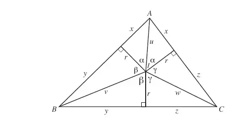

I came across this slick proof of Heron's formula on artofproblemsolving.com the other day. Heron's formula yields the area of a triangle given the lengths of its three sides: $$A = \sqrt{s(s-a)(s-b)(s-c)}$$ where $ s = \frac{1}{2}(a+b+c)$. The entire proof, by high schooler Miles Dillon Edwards, is reproduced here.
alt text
Let $I$ be the center of the incircle of $\triangle ABC$. Let $a = y + z$, $b = x + z$, and $c = x + y$ be the lengths of the sides opposite $A$, $B$, and $C$, respectively, and let $s = x + y + z$ be the semiperimeter of the triangle. Clearly $2 \alpha + 2 \beta + 2 \gamma = 2\pi$, so $\alpha + \beta + \gamma = \pi$. Now notice that $$(r + ix)(r + iy)(r + iz) = (u e^{i \alpha})(v e^{i \beta})(w e^{i \gamma}) = u v w e^{i(\alpha+\beta+\gamma)} = u v w e^{\pi i} = −uvw.$$ Therefore $$0 = \text{Im}[(r + ix)(r + iy)(r + iz)] = r^2(x + y + z) − xyz,$$ so $$r = \sqrt{\frac{x y z}{x + y + z}} = \sqrt{\frac{(s-a)(s-b)(s-c)}{s}}.$$ Thus the area of $\triangle ABC$ is $$\frac{r a}{2} + \frac{r b}{2} + \frac{r c}{2} = r s = \sqrt{s(s-a)(s-b)(s-c)}$$

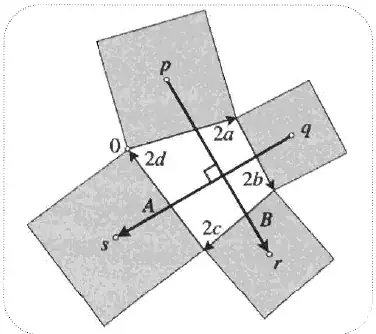

alt text
Theorem: The line segments joining the centers of opposite squares are perpendicular and of equal length.
Proof:
Let $2a,2b,2c,2d$ be complex numbers running along the edges of the quadrilateral.
Condition for quadrilateral to close up is
$a + b + c + d = 0$
Let origin be at vertex where $2a$ begins
so
$p = a + ia$ i.e. $a$ + ($a$ rotated though 90 degrees)
$ q = 2a + (1+i)b$
$r = 2a + 2b + (1+i)c$
$ s = 2a + 2b + 2c + (1+i)d$
$A = s-q$ and $B = r - p$
we want to show that A and B are perpendicular and equal i.e. $B = iA$
$A + iB = (a+b+c+d) + i(a+b+c+d) = 0 $ since $a + b + c + d = 0$
This image, theorem, proof and everything is taken from Visual Complex Analysis by Tristan Needham.[One of the Best Books. Highly Recommended.]
