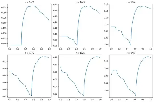

We'll show this by exhibiting a subset of the large disk that the smaller disks cannot cover more than $99.91\%$ of even if we count coverings with multiplicity, which is much easier to check. Specifically, we'll choose a set of four extremely thin rings centered around the origin, tuning their relative thicknesses to make the impossibility proof work out. We also renormalize so the central disk has radius $1$ and the smaller disks have radii in the set $R = \{1/\sqrt{2}, 1/\sqrt{3},\ldots,1/\sqrt{7}\}$.
By the Law of Cosines, the fraction of an origin-centered ring of radius $x$ covered by a disk of radius $r$ whose center is distance $d$ from the origin is
$$\frac{\arccos\left(\frac{d^2+x^2-r^2}{2dx}\right)}{\pi}$$
where we cap the output of $\arccos()$ if its input lies outside the range $[-1,1]$.
If we look at $x=1$, ie the perimeter of the disk, we can look at the fraction of perimeter covered by each disk as a function of $d$:
Adding up the maxima of these fractions for each $r\in R$ gives us a total covering fraction of $1.0173$, which doesn't rule things out as yet but suggests that we don't have much room to maneuver away from the perimeter.
Generalizing a bit, we'll add three more rings, so we look at $X =[x_1,x_2,x_3,x_4=1]$. We'll then weight these rings by $W = [w_1,w_2,w_3,w_4]$, where we normalize $W$ to sum to $1$. If we can find values of $X$ and $W$ such that
$$\sum_{r\in R}\max_{d\in[0,1+r]}\left(\sum_{i=1}^4\frac{w_i}{\pi}\arccos\left(\frac{d^2+x_i^2-r^2}{2dx_i}\right)\right) < 1$$
then we'll know the problem is impossible, since in any valid solution the sum of covered fractions along each ring (and hence any weighted sum thereof) would need to exceed 1. (We could also think of this as using an equally-weighted sum across a 2D region, where we each turn each ring into an annulus of thickness $\epsilon w_i/x_i$ - for small enough $\epsilon$, this will have behavior arbitrarily close to the above setting.)
I fed this function into scipy.optimize.minimize with the constraint that all weights be nonnegative and it spit out the solution $X=[0.05,0.2384,0.3932,1], W=[0.01785, 0.04577, 0.02912, 0.90725]$. With these parameters the maximum weighted sum is around $0.999005$. The weighted scores for each disk as a function of $d$ are graphed below:
  • Nice! Just a few comments about wording. Where you wrote "tuning their relative thicknesses" did you mean "tuning their radii"? Where you wrote "a disk of radius $r$ at distance $d$ from the origin" did you mean "a disk of radius $r$ whose centre is distance $d$ from the origin"? – Dan Jan 25 '24 at 12:37
  • Can you avoid the use of weights by using more rings? Do you have any references for simpler problems that use weights in a similar way? – Lewis Baxter Jan 25 '24 at 15:12
    By fiddling I found that X = [0.05, 0.24, 0.4, 1] and W = [0.02, 0.049, 0.03, 0.901] also works with sum about 0.9999916. – Lewis Baxter Jan 25 '24 at 15:50
    @Dan: Yes to your second question; for the first one, I was referring to tuning $W$, which can also be thought of as turning each 1D ring of radius $x_i$ and width $w_i$ into a very very thin 2D annulus with thickness $\epsilon w_i/x_i$ for some small epsilon and then weighting uniformly by area. I'll edit the post to make the wording clearer! – RavenclawPrefect Jan 25 '24 at 18:57
    @LewisBaxter yes; just choose some rational numbers very close to each $w_i$, then duplicate each ring so that the relative ratios work out. (If you want the rings to be distinct, you can of course add a very small perturbation to each ring by continuity.) – RavenclawPrefect Jan 25 '24 at 18:57
