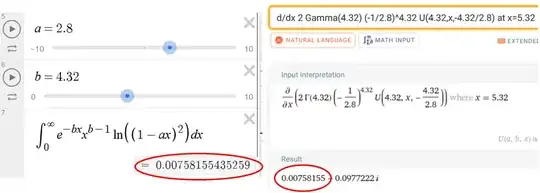

Example with random numbers: $a=2.8$ and $b=4.32$
  • How would you take the real part? – Тyma Gaidash Jan 19 '24 at 13:12
    @ТymaGaidash the short answer is that since he is using Wolfram he can simply write "Re" in the command. The long answer is that it must transform $U(a,b,-z)$ in terms of $U(a,b,z)$ and the hypergeometric function $_1F_1$ and then since $z>0$ it takes the real part in a simple way considering $(-1)^b=e^{\pi i b}$. Here the transformation: https://functions.wolfram.com/HypergeometricFunctions/HypergeometricU/16/01/01/ However, even this way the formula works and is very compact – Math Attack Jan 19 '24 at 14:00
