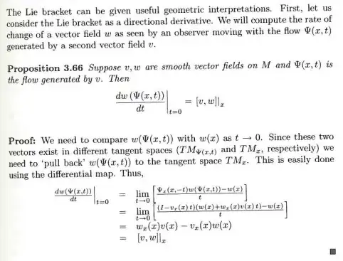

  • I have added the excerpt from the book. They use $v$ and $w$ instead of $X$ and $Y$. – Suba Thomas Nov 06 '23 at 19:06
    Thanks. This shows that -with the flow definition- ${\cal L}_XY=[X,Y]$ holds as well. Conclusion: unlike what I wrote in a now deleted comment: The Lie derivative is in general not a directional derivative $\partial_XY,.$ It is the difference of two such directional derivatives. Finally, ${\cal L}_XY=[X,Y]$ it is the rate of change of $Y$ as seen by an observer that moves with the flow of $X,.$ – Kurt G. Nov 06 '23 at 20:20
