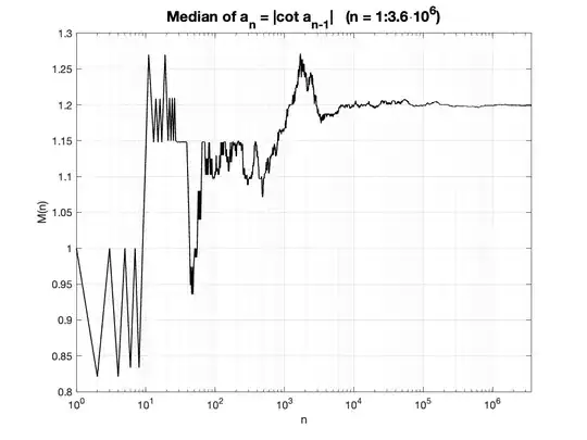

I've expanded my examination of this problem. I have run out the sequence to $n=10^7$ with $a_1=1$, as before. I attempted to find the median for each value of $n$ but it was too time consuming. I stopped the calculation at $n\approx 3.5\cdot10^6$ and then continued the calculation for the last 100,000 points. The results are shown in the two figures below. As you can see in the second figure, the results do not settle down to a constant value at all. It is my opinion that they never will.

Cye Waldman
  • 7,524
  • One thing to note is that numerical simulation of the sequence $(a_n)$, hence its median, is very susceptible to numerical errors. – Sangchul Lee Oct 07 '23 at 19:39
  • @SangchulLee Point taken, so how does your 10,000 (!) digit precision look out at, say, $n=10^6$. – Cye Waldman Oct 07 '23 at 19:57
  • Loss of digit is so severe that the computation encountered division-by-zero error around $n\approx 1.4\times 10^4$. If this trend continues, I guess we would need about 1,000,000 digit precision to reach terms around $n=10^6$. This will certainly drain my RAM and take eternity to be done... :( – Sangchul Lee Oct 07 '23 at 20:04
  • Interesting. I was able to compute $10^7 a_n$ in .5 secs (normal machine accuracy). But it took many many hours to compute $3\cdot10^6$ medians. By the way, do you know Prof. Rushan Ziatdinov at Keimyung University, Daegu, South Korea? – Cye Waldman Oct 07 '23 at 22:20
