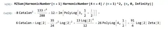

The structure of such sums in terms of multiple zeta values (MZVs) are considered well-understood. Several years ago I implemented an algorithm to calculate logarithmic integrals via MZVs, the algorithm for Euler sums is almost the same. Now you can compute them using the same Mathematica package.
An overview of the theory and algorithm behind can be learned here.
For OP's sum, one simply input enter image description here the program only accepts sum from $0$ to $\infty$, so we need to do a shift by $1$. This corroborates OP's result.

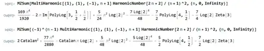

What OP called "skew-harmonic number" $\overline{H}_n = \sum_{i=1}^n \frac{(-1)^{i-1}}{i}$ is represented in the program as MultiHarmonic[{1},{1},{-1},n], the two sums OP mentioned can also be computed using same algorithm:
