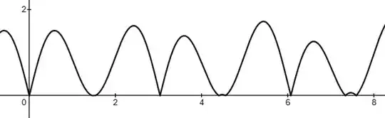

What is the mean value of $|\sin x +\sin (\pi x)|$ ?
Here is the graph of $y=|\sin x +\sin (\pi x)|$:
The mean value should be $\lim\limits_{n\to\infty} \frac{1}{n}\int_0^n |\sin x +\sin (\pi x)|dx$, but I don't know how to evaluate this. I tried complex numbers, to no avail.
