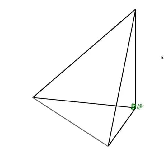

Second,now employing the De Gua's theorem for a tri-rectangular tetrahedron:enter image description here
Let the right angled sides have area $e,f,g$ and the hypotenuse side have area $h$,then it follows $e^2+f^2+g^2=h^2$
Notice that $e,f,g$ can be considered as projected areas of hypotenuse triangle with area $h$ on coordinate planes. Let them be the projections with $xy,yz,zx$ coordinate planes respectively. And from previous observations we can also conclude that : $$ \frac{e}{h}=cos(\alpha) $$ $$ \frac{f}{h}=cos(\beta) $$ $$ \frac{g}{h}=cos(\gamma) $$ where $\alpha,\beta,\gamma$ are the angles made by the hypotenuse face with the respective coordinate planes. Remember that we have already established that no matter how we deform the original closed curve, as long as its area is constant and the containing plane retains its orientation in the 3D space( that is its angles with the coordinate planes($\alpha,\beta,\gamma$) remains same). The area of projection will also remain constant.

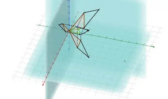

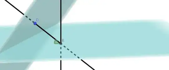

Coming to the perpendicularity of the vector $c$ to the plane containing vectors $a,b$. To understand this, imagine a unit vector $u$ perpendicular to the plane containing $a$ and $b$, let this plane be $P_{ab}$. Let the angles made by the plane $P_{ab}$ and coordinate planes $x-y,y-z,z-x$ once again be $\alpha,\beta,\gamma$ . Since $u$ is perpendicular to $P_{ab}$ the angles it makes with the coordinate planes $x-y,y-z,z-x$ will be $\frac{\pi}{2}-\alpha,\frac{\pi}{2}-\beta,\frac{\pi}{2}-\gamma$enter image description here And hence the angles it subtends with coordinate axes $X,Y,Z$ will be $\beta,\gamma,\alpha$ and hence the unit vector $u$ will have $cos(\beta), cos(\gamma),cos(\alpha)$ along them.Here, just to be clear, $\beta,\gamma,\alpha$ are angles of $u$ with axes$X,Y,Z$ and the angles of $u$ with coordinate planes $y-z,z-x,x-y$, respectively. Remember that $$ c=(a_{y}b_{z}-a_{z}b_{y})\hat{i}+(a_{z}b_{x}-a_{x}b_{z})\hat{j}+(a_{x}b_{y}-a_{y}b_{x})\hat{k} $$ has coefficients as area of projection of parallelogram formed by $a,b$ on $y-z,z-x,x-y$ for unit vectors $\hat{i}, \hat{j}, \hat{k}$ respectively. And we have already established that projected areas are $cos(\theta)$ times the original area, $\theta$ being the angle between the two planes.
Therefore vector $c$ also has unit vector same as vector $u$, i.e. $cos(\beta),cos(\alpha),cos(\gamma)$. Therefore vector $c$ is perpendicular to $P_{ab}$.
