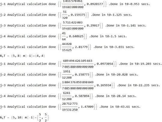

Now we are going to present a code snippet that uses equation $(2)$ along with the recurrence $(1)$ and confirms the result $(3)$. Here we took $N=5$, $p=-1$, $T= N+1-2 p+ 2 (0,1)$ and here we go:
(*Definitions *)
Clear[l]; Clear[lmb]; Clear[a]; mGamma[NN_, x_] := Pi^(NN (NN - 1)/4) Product[Gamma[(2 x - j)/2], {j, 0, NN - 1}]; Pfct[NN_, T_] := Pi^(NN^2/2) 2^(-NN T/2)/(mGamma[NN, NN/2] mGamma[NN, T/2]);
(Precompute mll[[]]) mll =.; Clear[Op]; mll = Table[{Exponent[#, Table[Op[xi], {xi, 1, mNN - 1}]], (# /. Op[j_] :> 1)} & /@ (List @@ Expand[Product[ Sum[Op[j], {j, i, mNN - 1}], {i, 1, mNN - 1}]]), {mNN, 2, 5}];
CC[2, lmb_List, a_List] := If[a[[1]] >= lmb[[1]] - 2 && lmb[[1]] >= 2, Binomial[a[[1]], lmb[[1]] - 2] (lmb[[1]] - 1)! (a[[1]] + a[[2]] + 2 - lmb[[1]])!, 0] ; l2 =.; CC[3, lmb_List, a_List] := Sum[With[{l2 = lmb[[3]] - 1 - a[[3]] - l1}, Binomial[a[[1]], l1] Binomial[a[[2]], l2] (lmb[[3]] - 1)! ( (lmb[[1]] - 1) ( lmb[[2]] - 1) CC[ 2, {lmb[[1]] - 1, lmb[[2]] - 1}, {a[[1]] - l1, a[[2]] - l2}] + (lmb[[2]] - 1) (lmb[[2]] - 2) CC[ 2, {lmb[[1]] - 0, lmb[[2]] - 2}, {a[[1]] - l1, a[[2]] - l2}] )] , {l1, Max[0, lmb[[3]] - 1 - a[[2]] - a[[3]]], Min[a[[1]], lmb[[3]] - 1 - a[[3]]]}]; l3 =.; Clear[lPochh]; lPochh[a_, n_] := Pochhammer[a - n + 1, n]; CC[4, lmb_List, a_List] := Sum[With[{l3 = lmb[[4]] - 1 - a[[4]] - l1 - l2}, Binomial[a[[1]], l1] Binomial[a[[2]], l2] Binomial[a[[3]], l3] (lmb[[4]] - 1)! ( 1 lPochh[lmb[[1]] - 1, 1] lPochh[lmb[[2]] - 1, 1] lPochh[ lmb[[3]] - 1, 1] CC[3, Drop[lmb, -1] - {1, 1, 1}, Drop[a, -1] - {l1, l2, l3}] + 1 lPochh[lmb[[1]] - 1, 0] lPochh[lmb[[2]] - 1, 2] lPochh[ lmb[[3]] - 1, 1] CC[3, Drop[lmb, -1] - {0, 2, 1}, Drop[a, -1] - {l1, l2, l3}] + 1 lPochh[lmb[[1]] - 1, 1] lPochh[lmb[[2]] - 1, 0] lPochh[ lmb[[3]] - 1, 2] CC[3, Drop[lmb, -1] - {1, 0, 2}, Drop[a, -1] - {l1, l2, l3}] + 2 lPochh[lmb[[1]] - 1, 0] lPochh[lmb[[2]] - 1, 1] lPochh[ lmb[[3]] - 1, 2] CC[3, Drop[lmb, -1] - {0, 1, 2}, Drop[a, -1] - {l1, l2, l3}] + 1 lPochh[lmb[[1]] - 1, 0] lPochh[lmb[[2]] - 1, 0] lPochh[ lmb[[3]] - 1, 3] CC[3, Drop[lmb, -1] - {0, 0, 3}, Drop[a, -1] - {l1, l2, l3}] )] , {l1, 0, a[[1]]}, {l2, Max[0, lmb[[4]] - 1 - a[[3]] - a[[4]] - l1], Min[a[[2]], lmb[[4]] - 1 - a[[4]] - l1]}];
CC[NN_Integer, lmb_List, a_List] := Sum[ With[{lastl = lmb[[NN]] - 1 - a[[NN]] - Sum[l[xi], {xi, 1, NN - 2}]}, Product[ Binomial[a[[xi]], If[xi == NN - 1, lastl, l[xi]]], {xi, 1, NN - 1}] (lmb[[NN]] - 1)! Sum[ If[ And @@ Table[ lmb[[xi]] >= mll[[NN - 1]][[which, 1, xi]], {xi, 1, NN - 1}], mll[[NN - 1]][[which, 2]] Product[ lPochh[lmb[[xi]] - 1, mll[[NN - 1]][[which, 1, xi]]], {xi, 1, NN - 1}] CC[NN - 1, Drop[lmb, -1] - mll[[NN - 1]][[which, 1]], Drop[a, -1] - Table[If[xi == NN - 1, lastl, l[xi]], {xi, 1, NN - 1}]], 0] , {which, 1, Length[mll[[NN - 1]]]}] ] , Evaluate[ Sequence @@ Join[Table[{l[xi], 0, a[[xi]]}, {xi, 1, NN - 3}], With[{tS = Sum[l[xi], {xi, 1, NN - 3}]}, {{l[NN - 2], Max[0, lmb[[NN]] - 1 - a[[NN - 1]] - a[[NN]] - tS], Min[a[[NN - 2]], lmb[[NN]] - 1 - a[[NN]] - tS]}}]]] ] /; NN >= 5;
NN = 5; p = -1; Do[(Loop over T values.) T = NN + 1 - 2 p + 2 xi; aa = (T - NN - 1)/2; S = 0; Clear[lmb]; Do[ a = Table[aa + If[xi == j, p, 0], {xi, 1, NN}]; A = ConstantArray[1, NN]; Ab = Accumulate[A]; t0 = TimeUsed[]; res = Flatten[ Table[{Table[ If[xi == NN, Total[a] + Binomial[NN + 1, 2], lmb[xi]] - If[xi == 1, 0, lmb[xi - 1]], {xi, 1, NN}], CC[NN, Table[ If[xi == NN, Total[a] + Binomial[NN + 1, 2], lmb[xi]] - If[xi == 1, 0, lmb[xi - 1]], {xi, 1, NN}], a] Product[ 1/ Ab[[xi]]^( If[xi == NN, Total[a] + Binomial[NN + 1, 2], lmb[xi]] - If[xi == 1, 0, lmb[xi - 1]]), {xi, 1, NN}]}, Evaluate[ Sequence @@ Table[{lmb[xi], If[xi == 1, 2, lmb[xi - 1] + 2], If[xi == 1, NN + a[[1]], Total[a] + Binomial[NN + 1, 2] - 1]}, {xi, 1, NN - 1}]]], NN - 2]; mres = Pfct[NN, T]/(NN T^p) 2^(Binomial[NN + 1, 2] + NN aa + p) Total[res[[All, 2]]]; S += mres; Print["j=", j, " Analytical calculation done ", {#, N[#]} & /@ {mres}, " .Done in t0=", TimeUsed[] - t0, " secs."]; , {j, 1, NN}]; S1 = Which[ p == -1, T/(T - NN - 1), p == -2, (T^2 (T - 1))/( Product[T - NN + j, {j, -0, 0}] Product[ T - NN - 2 j - 1, {j, 0, 1}]), p == -3, (T^3 (T - 1))/( Product[T - NN + j, {j, -1, 1}] Product[ T - NN - 2 j - 1, {j, 1, 2}]) (T + NN - 1), p == -4, (T^4 (T - 1))/( Product[T - NN + j, {j, -3, 2}] Product[ T - NN - 2 j - 1, {j, 2, 3}]) ((-2 + NN) (2 - NN - NN^2) - (-7 + 8 NN + 2 NN^2) T + 2 (NN - 2) T^2 + T^3), p == -5, (T^5 (T - 1))/( Product[T - NN + j, {j, -5, 3}] Product[ T - NN - 2 j - 1, {j, 3, 4}]) (-NN - 4 + T) (NN - 1 + T) (-(-3 + NN) (-2 + NN) (2 + NN) + (15 - 18 NN - 4 NN^2) T + 4 (NN - 1) T^2 + T^3)]; Print["N,T = ", {NN, T}, " m[", p, "]=", {S, S1}]; , {xi, 0, 1}];
As we can see the match is perfect. Unfortunately the calculations are pretty slow because for every $N,T,p$ we have to change the vector $\vec{a}$ in ${\mathfrak J}_N^{\vec{a}}(\vec{A})$. As an overall conclusion we can say that this method is best suited for the case $\vec{a}$ being fixed and $\vec{A}$ being arbitrary because in that case we just pre-compute the coefficients once and then use them for all possible $\vec{A}$'s.
