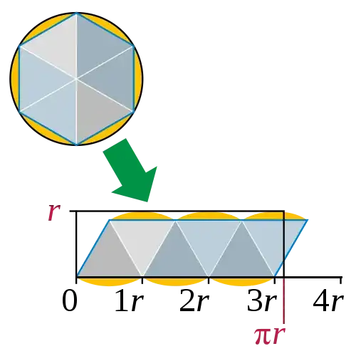

Now, to find the constant $b$, I think the easiest way is to look at this Wikipedia diagram: enter image description here
This shows how when you subdivide the circle into many equal small triangles, the area becomes a rectangle with height $r$ and length equal to half the circumference of the circle, which is $\pi r$, by the definition of $\pi$.

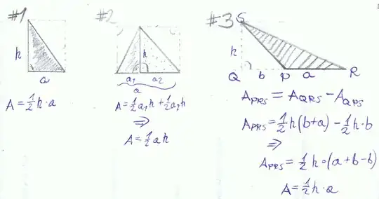

Introduction:
Properties of the Area(s) of a triangle:

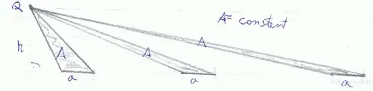

I. Properties #1-#3: enter image description here II. Property #4: Constant area:

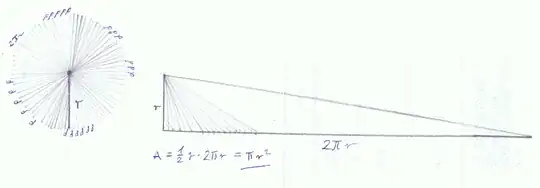

Let have a circle with the radius $r$. We split the circuit into equal $d$ parts (in best case: infinitesimal short parts); now we imaginate a cut once into the center- so we get kinda a handheld fan with a lots of quasi-triangles. last move is to use property #4: enter image description here
