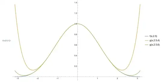

As an example, here is a plot comparing $f(x,a)=\operatorname{sinc}^ax$ to the series expansion $g(x,a,M)$ for $a=2.5$ and $M=4,6$ showing the expansion converging to the target function as the number of terms increases. Example Plot
