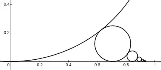

To help you visualize, here is a chain of circles of radius $1/n^{3}$.
