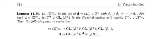

We will use the his book, Lemma 11.50 :
Here, $R^{+} := k[T], R^{-}:=k[T^{-1}], R^{\pm}:=k[T,T^{-1}]$.

Now, to show the underlined statement, fix a vector bundle $\mathcal{E}$ of rank $n$ on $\mathbb{P}_k^{1}$. By the above Lemma 11.50, there exists a $\mathbf{d}:=(d_1 \ge d_2 \ge \cdots \ge d_n) \in (\mathbb{Z}^{n})_{+}$ such that $\psi(\mathcal{E})=GL_n(R^{+})T^{\mathbf{d}}GL_n(R^{-1})$.
