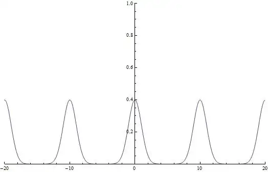

I have some function, say, Gauss PDF
Now I want it to repeat, say, every N units
How to transform any function this way?
I know I can sum function at each shift. But is it possible to convert argument only? I.e. apply some transform to $x$ only?

12
If you say $$p(x) = f(x\bmod N)$$
then $p$ is a periodic function with period of $N$, which has $p(x)=f(x)$ for all $x$ in $[0, N)$.
To make $p$ and $f$ agree on an interval that is symmetric around 0, you can use $$p(x) = f\left(\left(\left(x + \frac N2\right)\bmod N\right) - \frac N2\right)$$
which is again a function that has a period of $N$, but this time $p(x) = f(x)$ for all $x$ in $\left[-\frac N2, \frac N2\right)$.
If that's not what you want, please clarify what your question is.

  • These solutions effectively multiply the original function be a rectangular window before summing the function at each shift. More generally, you could use some other window function. For example, a smoother window would help to smooth out any discontinuities. In a way, this is a family of hybrid solutions between Suzan's and yours. – Chris Culter Jul 28 '13 at 19:59
  • So perhaps my answer isn't really pertinent? – MJD Jul 28 '13 at 20:02
  • Oh, I think your answer is extremely pertinent! It answers the original question: "But is it possible to convert argument only?" Using a non-rectangular window would mean doing more than just changing the argument to $f$. – Chris Culter Jul 28 '13 at 20:08
  • @ChrisCulter you could say that this means changing the argument to the "sawtooth curve" $x \pmod{n}$ – Ben Grossmann Jul 28 '13 at 20:12
    @Omnomnomnom Yes, sorry, I should be clearer. I'm agreeing that MJD's answer is a positive solution to the question. My idea, on the other hand, breaks the rule by summing up a nonzero multiple of $f$ at more than one argument. – Chris Culter Jul 28 '13 at 20:15
  • Thanks for clarifying. I feel like I don't understand the context of the original question very well, so I wasn't at all sure that my answer would be useful. – MJD Jul 28 '13 at 21:12
  • @MJD I was thinking about this way. But this way I cut all values outside period, i.e. if function is not localized, that periodic version will notably differ. – Suzan Cioc Jul 29 '13 at 08:57
