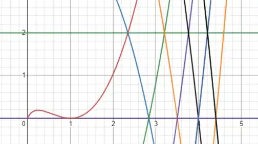

If the bounding lines are $y = a$ and $y = b$, then what you are probably looking for is the function $$y = \frac{b - a}{\pi}\Big(\arccos(\cos \pi x)\Big) + m.$$
You can modify the angle of reflection by changing $\pi x$ to $\frac{\pi x}{c}$ for a nonzero $c$ where $c$ is the slope of the line from the origin.
Check the graph from Desmos through this link here.
Update:
I can't find a solution right now to get all functions, even the endpoints. This only works for polynomials, roots, and compositions of both.
Let $f$ and $g_n$ be the original function and the function defined for the interval before the $n$th interval. Then, the function must be $$f_n(x) = \left(-1\right)^{p+1} g(x) +n(b - a)$$ where $$n=(p-(1/2)+(1/2)(-1)^{p})(-1)^{p}$$ and $p$ is an integer starting from $1$.
Try to replace $f(x)$ in this Desmos graph and see if it works under certain conditions.
Let's test a function, $g(x) = 3(x - \sqrt{x})^2$ with boundaries $y = 0$ and $y = 2$ for $p$ up to $9$.
