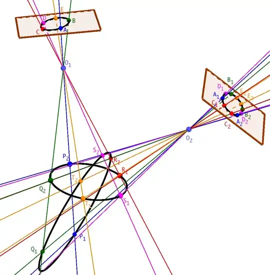

I'll suggest then a different approach. Take five points $ABCDE$ on the first image and consider the five lines $abcde$ passing through each point and the center $O_1$ of the first camera. The images of these lines, relative to the second camera, can then be constructed: they are five lines lying in the plane of the second image, each of them intersecting it at two points: $(A_1,A_2)$, $(B_1,B_2)$ and so on. If $O_2$ is the center of the second camera, we can then construct the intersection point $P_1$ between line $A_1O_2$ and line $a$, and the intersection point $P_2$ between line $A_2O_2$ and line $a$. Points $P_1$ and $P_2$ lie then on the intersection of the cones, each on a different conic.
We can similarly find the other four couples of points on the intersection: $(Q_1,Q_2)$, $(R_1,R_2)$ and so on. Five of these ten points lie on the first conic, and the others lie on the second conic, but we don't know which lies on which. To find out, we can consider all $32$ possible cases $(P_i,Q_j,R_k,\dots)$ and check if all five points lie on a the same plane: this should be true only in two cases, which are then five points on each of the two possible conics. These can then be constructed.
See here for a geometrical construction of center and axes of an ellipse, given five points.
EDIT.
You can see below an example of the construction, made with GeoGebra. Note that $O_1$ and $O_2$ are on the same side of the plane of the first solution (ellipse $P_2Q_2R_1S_1T_1$) while they are on opposite sides of the plane of the second solution (ellipse $P_1Q_1R_2S_2T_2$). If this kind of information is given one can then isolate the right solution.
