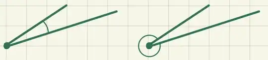

I'd like to post what I've gleaned so far from comments/answers/references.
In Euclidean geometry, an angle is just a vertex and two rays.
However, "angle" is also used to designate the measure of a Euclidean angle, where measure is just the ratio of a circular arc centered at the vertex to the radius of the circular arc. This is, however, ambiguous because there are two possible circular arcs.
Wikipedia says
The size of a geometric angle is usually characterized by the magnitude of the smallest rotation that maps one of the rays into the other.
which means the first angle in the picture above is "usually" the one referred to when we say "angle" and are referring to the specific vertex and rays in the picture above.
Moving on, a measure or magnitude is always non-negative, so angles are always non-negative.
Angles that have the same measure (ie the same magnitude) are said to be equal.
Given the ideas above, it seems that under Euclidean geometry, the following angles are all different, but if we use the word "angle" as the measure of a Euclidean angle in the "usual" sense as described by Wikipedia, then the following angles are all equal.
It is possible for two angles to have the same Euclidean angle specification (same vertex, same rays), but to have a measure that differs by an integer multiple of a turn of the chosen circular arc used to measure the angles. These angles are called coterminal, and any angle has an infinite number of coterminal angles.
