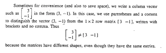

You need to clarify your notation. For example, from page 39 of David Lay's Linear Algebra: enter image description here
Following this convention, $$ y=\begin{bmatrix} x_{1} \\ x_{2} \\ x_{3} \end{bmatrix} = (x_{1},x_{2},x_{3}) \ne [x_{1} \;\;x_{2} \;\;x_{3}]=y^T.$$
