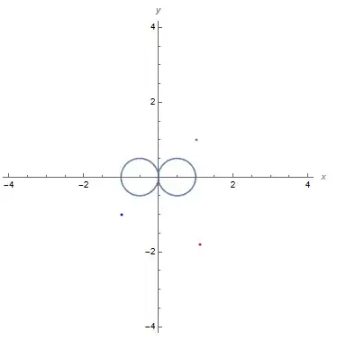

The following code makes plot of multiplication of two points:
p1 := {1, 1}
p2 := {-1, -1}
p := Multiply[p1, p2] // N
ContourPlot[(x^2 + y^2)^2 == x^2, {x, -4, 4}, {y, -4, 4},
 Axes -> True, AxesLabel -> Automatic, Frame -> None,
 Epilog -> {Gray, Point[p1], Blue, Point[p2]}, Red, Point[p]]
