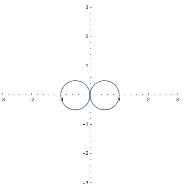

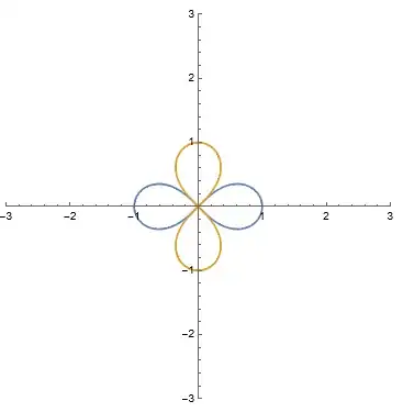

Now, the most promising shapes are the reciprocals of the shapes of split-complex and dual numbers, which are lemniscates:
$r(\phi)=\sqrt{\cos ^2(\phi)-\sin ^2(\phi)}$
In this system $M(z)=\frac{a^2+b^2}{\sqrt{2 a^2-\left(a^2+b^2\right)}}$ and $\operatorname{arg} z=\frac{a b}{a^2 + b^2}$ (this formula is valid only for the first quarter, otherwise a piecewise definition is needed).
and
$r(\phi)=|\cos(\phi)|$
In this system the magnitude is $M(z)=\frac{a^2 + b^2}a$ and argument is $\operatorname{arg} z=\frac{1}{4}\left(\frac{a b}{a^2+b^2}+\arctan\left(b/a\right)\right)$ (this formula is valid only for the first quarter, otherwise a piecewise definition is needed).

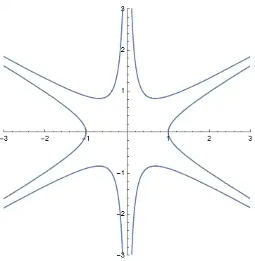

As well as hexagonally symmetrical "hyperbola"
$r(\phi)=\frac{1}{\sqrt{\cos ^2\left(\frac{3 \phi }{2}\right)-\sin ^2\left(\frac{3 \phi }{2}\right)}}$
It seems that the first two have infinitely large elements, for instance, in the second one it is $\omega=(0,1)$. The third one has zero divisors and (seemingly) idempotents.
