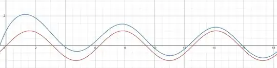

Can this definition be extended to the case where the "attracting" point depends in time (so that $x^*(t)$ is now an arbitrary solution) ? For example, in the below figure let the red line depicts $x^*(t)$, the attracting point at time $t$. Then the blue line shows $x(t)$ approaching $x^*(t)$ at every time (in the sense that the gap between the red and blue never grows).
To be a bit more formal, I want $x(t) = x^*(t)$ for all $t \geq 0$ if $x(0) = x^*(0)$, and if instead we have $\left | x(0) - x^*(0) \right | < \delta$ then for all large enough time values $t \geq t_0$ we have $\left | x(t) - x^*(t) \right | < \epsilon$.
