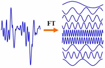

Since everyone is defining the space, I figured I could give an example of why we use it (relating to your "Electrical Engineering" reference). The $i$ itself is what makes using complex numbers/variables ideal for numerous applications. For one, note that:
\begin{align*} i^1 &= \sqrt{-1}\\ i^2 &= -1\\ i^3 &= -i\\ i^4 &= 1. \end{align*} In the complex (real-imaginary) plane, this corresponds to a rotation, which is easier to visualize and manipulate mathematically. These four powers "repeat" themselves, so for geometrical applications (versus real number manipulation), the math is more explicit.
One of the immediate applications in Electrical Engineering relates to Signal Analysis and Processing. For example, Euler's formula: $$ re^{i\theta}=r\cos\theta +ir\sin\theta $$ relates complex exponentials to trigonometric formulas. Many times, in audio applications, a signal needs to be decomposed into a series of sinusoidal functions because you need to know their individual amplitudes ($r$) and phase angles ($\theta$), maybe for filtering a specific frequency:
Fourier Transform
This means the signal is being moved from the time-domain, where (time,amplitude) = $(t,y)$, to the frequency domain, where (sinusoid magnitude,phase) = $(r,\theta)$. The Fourier Transform (denoted "FT" in the picture) does this, and uses Euler's Formula to express the original signal as a sum of sinusoids of varying magnitude and phase angle. To do further signal analysis in the $\mathbb{R}^2$ domain isn't nearly as "clean" computationally.

To augment Kendra Lynne's answer, what does it mean to say that signal analysis in $\mathbb{R}^2$ isn't as 'clean' as in $\mathbb{C}$?
Fourier series are the decomposition of periodic functions into an infinite sum of 'modes' or single-frequency signals. If a function defined on $\mathbb{R}$ is periodic, say (to make the trigonometry easier) that the period is $2\pi$, we might as well just consider the piece whose domain ins $(-\pi, \pi]$.
If the function is real-valued, we can decompose it in two ways: as a sum of sines and cosines (and a constant): $$ f(x) = \frac{a_0}{2} + \sum_{n=1}^{\infty} a_n \cos(nx) + \sum_{n=1}^{\infty} b_n \sin(nx)$$ There is a formula for the $a_k$ and the $b_k$. There is an asymmetry in that $k$ starts at $0$ for $a_k$ and at $1$ for $b_k$. There is a formula in terms of $\int_{-\pi}^{\pi} f(x) \cos(kx)dx$ for the $a_k$ and a similar formula for the $b_k$. We can write a formula for $a_0$ which has the same integral but with $\cos(0x) = 0$, but unfortunately we have to divide by 2 to make it consistent with the other formulae. $b_0$ would always be $0$ if it existed, and doesn't tell us anything about the function.
Although we wanted to decompose our function into modes, we actually have two terms for each frequency (except the constant frequency). If we wanted to say, differentiate the series term-by-term, we would have to use different rules to differentiate each term, depending on whether it's a sine or a cosine term, and the derivative of each term would be a different type of term, since sine goes to cosine and vice versa.
We can also express the Fourier series as a single series of shifted cosine waves, by transforming $$ a_k \cos(kx) + b_k \sin(kx) = r_k \cos(kx + \theta_k) .$$ However we now lost the fact of expressing all functions as a sum of the same components. If we want to add two functions expressed like this, we have to separate the $r$ and $\theta$ back into $a$ and $b$, add, and transform back. We also still have a slight asymmetry - $r_k$ has a meaning but $theta_0$ is always $0$.
The same Fourier series using complex numbers is the following: $$ \sum_{n=-\infty}^{\infty} a_n e^{inx} .$$ This expresses a function $(-\pi, \pi] \rightarrow \mathbb{C}$. We can add two functions by adding their coefficients, we can even work out the energy of a signal as a simple calculation (each component $e^{ikx}$ has the same energy. Differentiating or integrating term-by-term is easy, since we are within a constant of differentiating $e^x$. A real-valued function has $a_n = a_{-n}$ for all $n$ (which is easy to check). $a_n$ all being real, $a_{2n}$ being zero for all $n$ or $a_{n}$ being zero for all $n < 0$ all express important and simple classes of periodic functions.
We can also define $z = e^{ix}$ and now the Fourier series is actually a Laurent series: $$ \sum_{n=-\infty}^{\infty} a_n z^{n} .$$
The Fourier series with $a_n = 0$ for all $n < 0$ is a Taylor series, and the one with $a_n$ all real is a Laurent series for a function $\mathbb{R} \rightarrow \mathbb{R}$. We are drawing a deep connection between the behavior of a complex function on the unit circle and its behavior on the real line - either of these is enough to specify the function uniquely, given a couple of quite general conditions.
