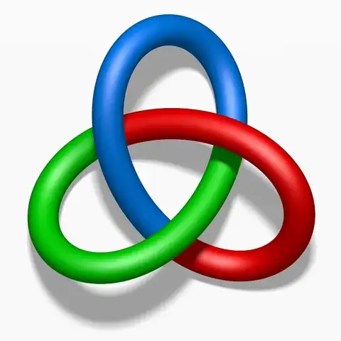

Topological and illustrated version of Arthur's nice answer:
A trefoil knot $K_3$ in $\Bbb R^3$ cannot be unknotted but it can be in $\Bbb R^4$. Topologically a trefoil knot $K_3$ and a circle are homeomorphic i.e. one can deform one to other without cutting or gluing. So these two (one in $\Bbb R^3$ and one in $\Bbb R^4$) are the same but one uncovers a branch of mathematics known as Knot_theory while other one is fruitless from this point of view and application.
I think theses type of "same things" is a categorical notion but I am not sure.
same is true for $y=x$ and $y=\exp(x)$; both topologically are homeomorphic to $\Bbb R$, but one contains only positive numbers. One can say similar properties by considering them as additive and multiplicative groups.
