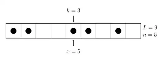

There is a trivial discrete analog. Imagine $L$ boxes in a linearly-ordered row, with $n$ balls in the boxes, such that there are no more than 1 ball in each of the boxes. The probability for the $k$th ball (reading left-to-right) to be in box $x$ is $\binom{x-1}{k-1} \binom{L-x}{n-k}/\binom{L}{n}$ for each possible choice of $x$. (Note that, summing over $x$, this generalizes the ``hockeystick identity'' for binomial coefficients in a trivial way.) This is not quite the same: here the primary interpretation is in terms of the $k$th order-statistics.
example of balls in boxes
The binomial(n,p) distribution is replaced by a capture-recapture hypergeometric distribution, which is not as straightforward as the binomial. Imagine a population of $L-1$ elephants and you capture and tag a uniformly distribution random number $\mathsf{Y}$ elephants, and set $x=y+1$ if $\mathsf{Y}=y$. (This hypothesis is admittedly a bit odd in this context.) Then you randomly collect a new sample of $n-1$ of the elephant population. You discover $k-1$ of your new sample were tagged and $n-k$ were not. What is your updated guess for $y$?
