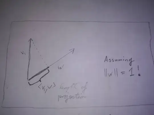

If you draw a $2D$ picture of this, with $v, w$ two vectors on the unit circle, and project one of them orthogonally to the other, and compare with the high school definition of cosine, you'll see that this naturally leads to the final intuitive viewpoint:
3. Projections
For the dot product on $\mathbb R^n$, we know that $\langle v, e_i \rangle$ gives the $i$-th coordinate of $v$. Or, we can describe the projection of $v$ to the $i$-th coordinate as the vector pointing in direction $e_i$ with length $\langle v, e_i \rangle$.
Now the final core idea of inner products is to vastly generalize this to:
If $w$ is a vector of length 1, then $\langle v, w \rangle$ is the length of the projection of $v$ onto (the line through) $w$.
Which, if vectors are visualized as arrows, should make you see this picture:
And after the lengths motivated property 4, and angles motivated property 3, this projection business should motivate the first two properties, as it is quite clear that
  • the projection of a scaled vector is just scaled accordingly, $\langle av, w\rangle = a\langle v, w\rangle$, and
  • the projection of a sum is the sum of the projections: $\langle v_1+v_2, w \rangle =\langle v_1, w \rangle + \langle v_2, w\rangle$.
NB: For this we assumed that $w$ has length $1$. Keeping such $w$ fixed, we then stretch $v$ to see that its projection on $w$ stretches with the same factor. But what if instead we stretch the other vector $w$? The projection of $v$ on $w$ is of the same length as the projection of $v$ on $aw$ for any $a \neq 0$. It is a nice little exercise to infer from this that for a vector $w$ of general positive length, the projection of $v$ on $w$ has length $\dfrac{\langle v,w \rangle}{\langle w,w \rangle}$.
