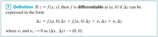

  3. That $u: \mathbb R^2 \to \mathbb R$ is real-differentiable at a point $(a,b)$ is defined as this weird thing from James Stewart, Calculus (similar for $v$)
