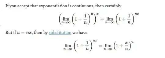

I am trying to prove, from the following limit definition of $e$ $$e=\lim_{n\to+\infty} \left(1+\frac{1}{n}\right)^n$$ the following definition for the exponential function: $$e^x =\lim_{n\to+\infty} \left(1+\frac{x}{n}\right)^n$$
I tried to follow the answer of this post, but there is something I don't understand: Prove $e^x$ limit definition from limit definition of $e$.
Here is a screenshot:
Screenshot from another thread
To substitute $n$ for $u$ in the limit "index", we need to make sure that $u$ goes to $+\infty$ as $n$ goes to $+\infty$. Therefore, we should have: $$\lim_{n\to+\infty} u = \lim_{n\to+\infty} nx \stackrel{?}{=}+\infty$$ Which is, in some way, $(+∞)*x$. That is fine if $x$ is positive, but what if $x$ were negative? Wouldn't that limit then be equal to $(-∞)$, which would invalidate that "re-indexing"?
Is the proof missing something, or am I wrong?
Thanks in advance! (The reason I am writing this here and not commenting is that the site settings forbid me to, because of my limited activity.)

  • You should note that $(1+x/n)^n$ tends to $e^x$ even if $n\to-\infty $ – Paramanand Singh Aug 22 '21 at 01:51
    I dislike that argument for another reason. It is an (unstated) rule that $\lim_{n\to\infty} f(n)$ is a limit of a sequence, $f(1),f(2),f(3),…$ But $x$ is not necessarily an integer when computing $e^x.$ Replace $xn$ with $m$ and then take $m\to\infty,$ because $m$ is not necessarily an integer. – Thomas Andrews Aug 22 '21 at 01:53
  • @ParamanandSingh, thank you. Now that you mention it, it seems completely reasonable. – Zartrix Aug 22 '21 at 02:26
  • @ThomasAndrews, I understand the convention and the confusion it causes in that context. However, this is only for my personal understanding, but if I were to redact a formal proof of it, I'll remember that. Thanks! – Zartrix Aug 22 '21 at 02:26
