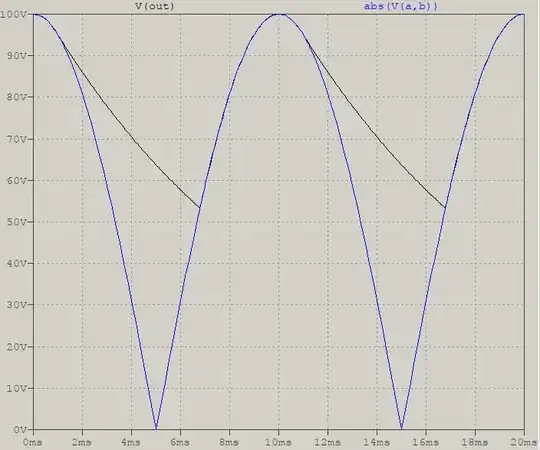

I shouldn't have presumed people to know what a full-wave rectifier with parallel RC load is or does, so for the sake of clarity this is what interests me:
The (ideal) theory is that the sine wave charges the capacitor. At the peak and for a short interval after it (on the downslope), the voltage across the capacitor is the same as the sine. When the two slopes are equal, the capacitor voltage is no longer a sine but an $\mathrm{e}^{-x}$, continuing from the last voltage value. The sine has an absolute value, so the second half of the period sees the value of the sine rising again, until it meets the discharging exponential -- this is what is needed here. The cycle continues:
cycle
For the sake of simplicity, here, on math.se, the question deals with a generic formula, (1), not the absolute value of it, and no complications with finding out the time and value when the capacitor voltage stops being a sine and continues as an exponential. There are also no time constants involved, or frequencies, therefore, the simplified version looks like this:

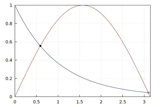

The capacitor discharges with the blue trace until it meets the red trace. Only the first point of intersection is needed (black dot), any other subsequent points are discarded (green circle). If this is solved, then $\mathrm{e}^{-ax}=\sin(bx)$ can also be solved, and even the moment when the waveform switches shapes, though I suspect that will be a tad more complicated (and not part of this question).

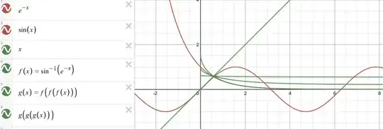

As always there is also recursive solution which is simpler, but still has an infinite number of terms like the other answer’s series. Please see this graph.Here are two ways to find the answer as $x=$ some recursive function with solution as (solution, solution) because of the nature of the identity function $y=x$:You can easily use the angle plus $2\pi n$ method to find the other angles as well.
$$e^{-x}=\sin(x)\implies A_0(x)=x=\sin^{-1}\left(e^{-x}\right)=A_1(x)\implies x=\lim_{n\to \infty}A_n(x)=A_{\infty}(x)=\sin^{-1}\left(e^{-{\sin^{-1}\left(e^{-…}\right)}}\right), A_{n+1}(x)= \sin^{-1}\left(e^{-A_n(x)}\right)$$
You can substitute a value for x and get a result as well for $A_n(x)$ because the approximations converge a horizontal solution line. Please also correct me and give me feedback.

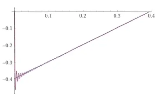

The series correctly gives $h(f(x))-\frac\pi8=x-\frac\pi8$:
so the series definitely converges to the inverse function despite being pretty slow. Therefore:
