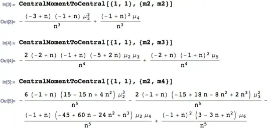

  • Second Row:
where $\mu_i$ denotes the $i$th central moment of the population of $X$.

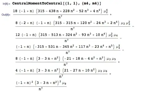

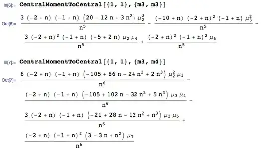

  • Third Row:
  • Fourth Row:
All other results by symmetry.

Other: Comment on OP's 'solution' using Mathematica
The OP writes:
The covariance matrix of the first four central moments for a normal random variable is:
<p>$$
\left( \begin{array}{cccc} s^2 & 0 & 3 s^4 & 0 \ 0 & 2 s^4 & 0 & 12 s^6 \ 3 s^4 & 0 & 15 s^6 & 0 \ 0 & 12 s^6 & 0 & 96 s^8 \ \end{array} \right) $$ and can be obtained e.g. in Mathematica using the command
Covariance[ TransformedDistribution[{x, x^2, x^3, x^4}, Distributed[x, NormalDistribution[0, s]]]]
This is incorrect for a variety of reasons:
  • First, you assert that you are calculating the covariance matrix for the first 4 CENTRAL moments. Please note that the first 4 Central moments are constants ... not random variables ... so the covariance matrix of the first 4 central moments is a null matrix ... which is obviously not what you want.
  • Second, there is nothing central about your calculation in Mathematica, since you have set the mean mu to 0, ... so it is all raw.
  • Third, what you are actually calculating here is $\operatorname{cov}(X^i, X^j)$ for $i,j$ = 1 to 4 when $X$ ~ $N(0,s^2)$. This is not the problem posed at the top, namely to find $\operatorname{cov}(m_i, m_j)$ for $i,j$ = 1 to 4.
wolfies
  • 5,174
  • thanks for the comments; I edited the question regarding the Mathematica bit: is it correct now? – Valerio Jun 16 '13 at 12:59
  • what would the first line be if instead of $m_1$ one uses $s_1 /n$ when calculating the covariance? – Valerio Jun 16 '13 at 13:01
  • Valerio asked: I edited the question regarding the Mathematica bit: is it correct now? ... The mma component of the question is still incorrect: The mma code is still calculating: $\operatorname{cov}(X^i, X^j)$ for $i,j$ = 1 to 4 when $X$ ~ $N(0,s^2)$. This is not the problem posed at the top, namely to find $\operatorname{cov}(m_i, m_j)$ for $i,j$ = 1 to 4. Nor does the calculation of $\operatorname{cov}(X^i, X^j)$ assist in deriving the calculation of $\operatorname{cov}(m_i, m_j)$. – wolfies Jun 16 '13 at 14:02
