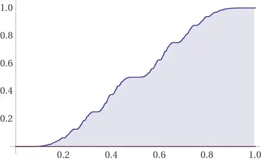

Here is what the constant looks amazingly like: enter image description here

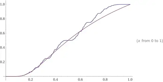

This result seems correct for a closed form with the exponential integral function:enter image description here
