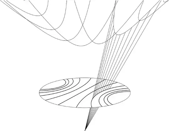

  • The conformal disk model (or Poincaré model), the open unit disk in the plane $z = 0$ with the metric $\frac{4(dx^{2} + dy^{2})}{(1 - (x^{2} + y^{2}))^{2}}$ induced by projection from the point $(0, 0, -1)$, see diagram. Because the metric is a scalar multiple of the Euclidean metric $dx^{2} + dy^{2}$, hyperbolic angles coincide with Euclidean angles. Geodesics turn out to be arcs of circles meeting the unit circle at right angles. At first glance this metric appears flat; see below.
Projecting the hyperboloid to the disk
