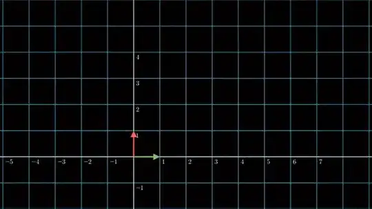

A matrix represents a Linear transformation. We can think about a Cartesian coordinate system and a linear transformation applied to it which lands $\hat{i}$ to (a,b) and $\hat{j}$ to (c,d). This transformation can be represented by a matrix $\begin{bmatrix} a & c\\ b & d \end{bmatrix}$ .
A vector which was originally at (x,y) lands to new postion $$x \begin{bmatrix} a \\ b \end{bmatrix} + y \begin{bmatrix} c \\ d \end{bmatrix} $$ $$= \begin{bmatrix} ax+by \\ cx+dy \end{bmatrix}$$ So the new coordinates of the vector is $(ax+by,cx+dy)$. This is explained neatly by 3b1b in this video
Determinant
When we change the basis vectors and hence the coordinate system, any square or circle or any kind of area in the coordinate system also gets scaled by some amount. This is called determinant.
If we multiply the initial area to the determinant, we get the final area.
https://youtu.be/Ip3X9LOh2dk

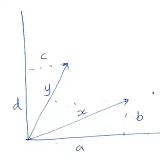

So currently the basis vectors is like this:
drawn diagram
Now, we should bring both the vectors to the axes. For that we should change the y-coordinate of x and x-coordinate of y. But how much? Remember that x and y are the new basis vectors and all the transformation is done according to these.
Initially the tip of X vector is has a y-coordinate of $b \hat{j}$ where $\hat{j}$ is the unit vector in the y direction.
But now Y is the new basis vector. So, $b Y$ is the current y coordinate of X. So to bring it back, you must scale it by $-b Y$. Similarly, You must multiply $-c X$ to the X vector to bring it to the X axes. So, the corresponding matrix is:
$\begin{bmatrix} ? & -c\\ -b& ? \end{bmatrix}$
Now we have two vectors in the x and y axes but they are of unequal length. First lets find their length:
Image here
So, vector X has length $a - \frac{bc}{d}$ and
Vector Y has length $d - \frac{bc}{a}$
To make both equal multiply X with d and Y with a.
Now, we have two vectors with length $ad-bc$.
So, the matrix to bring the X and Y back to the orthogonal axes and to make it equal is :
$\begin{bmatrix} d & -c\\ -b& a \end{bmatrix}$
This is also called the adjoint of the matrix. But we are not done yet: the unit basis vectors has a length of 1.
To make it the original unit matrix, we have to divide both by ad-bc. since this is just the determinant of the matrix,
$$inv(A) = \frac{adj(A)}{det(A)}$$
