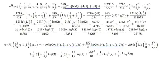

This constant mentioned by OP probably cannot be expressed in terms of ordinary polylogarithm, at least not the familiar $\operatorname{Li}_n(1/2), \operatorname{Li}_n((1\pm i)/2), \operatorname{Li}_n(1 \pm i)$. However, we do have a hypergeometric representation.
The series given by OP is $-6$ times the integral $$\int_0^1 \frac{\log ^{3}\left(x\right) \log \left(x^2+1\right)}{x^2+1} \, dx = -6 \Im(\text{QMZ}(4,\{4,1\},\{1,0\}))-6 \Im(\text{QMZ}(4,\{4,1\},\{1,2\}))$$ here $$\text{QMZ}(4,\{4,1\},\{1,0\}) = \sum_{n>m\geq 1}\frac{i^n}{n^4m}$$ $$\text{QMZ}(4,\{4,1\},\{1,2\}) = \sum_{n>m\geq 1}\frac{i^n (-1)^m}{n^4m}$$
In the paper, it is proved that ($C$ is Catalan constant, $\zeta(\cdot,\cdot)$ is Hurwitz's zeta) enter image description here
so we can solve for the underlined terms, and conclude that the integral, hence original series, can be written as two ${_6F_5}$.
