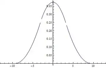

Here is a plot of the integral over $u$:
FT plot
(The gaps are an artifice of Mathematica and are not real.) It is interesting that the $1/t^3$ behavior of the integrand leads to a discontinuity in the second derivative - just as $1/t$ behavior leads to a discontinuity in the function value and $1/t^2$ behavior leads to discontinuity in the derivative.

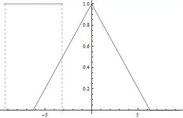

The problem of evaluating the integral above reduces to evaluating the convolution of two very simple functions having finite support. The following picture illustrates what needs to be done:
conv
Here, the rectangle (i.e. $\hat{f}(u-u')$) moves from left to right along the $u'$ axis, while $\hat{g}(u')$ stays fixed. The convolution at a particular value of $u$ is the overlap area. The form of this overlap area will vary depending on the value of $u$. For example, it should be clear that the overlap area is zero when $|u| \gt 3 \pi$. (The near edges of the rectangle lie outside the triangle.)
Now, when $u \in [-3 \pi,-\pi]$, the overlap area is a right triangle extending from the left vertex of the triangle to the right side of the rectangle (see the figure above). That is,
$$\begin{align}I(u) &= \frac{1}{4 \pi} \int_{-2 \pi}^{u+\pi} du' \left ( 1+ \frac{u'}{2 \pi}\right )\\ &= \frac{u+3 \pi}{4 \pi} + \frac{(u+\pi)^2-4 \pi^2}{16\pi^2}\\&= \frac{1}{16 \pi^2} (u+3 \pi)^2 \end{align} $$
When $u \in [\pi, 3 \pi]$, the situation is the mirror image:
$$\begin{align}I(u) &= \frac{1}{4 \pi} \int_{u- \pi}^{2\pi} du' \left ( 1- \frac{u'}{2 \pi}\right )\\ &= \frac{u-3 \pi}{4 \pi} - \frac{4 \pi^2-(u-\pi)^2}{16\pi^2}\\&= \frac{1}{16 \pi^2} (u-3 \pi)^2 \end{align} $$
Finally, when $u \in [-\pi,\pi]$, the overlap area is bounded on both sides by the rectangle:
$$\begin{align} I(u) &=\frac{1}{4 \pi}\int_{u-\pi}^0 du' \left ( 1+\frac{u'}{2 \pi}\right) +\frac{1}{4 \pi} \int_0^{u+\pi} du' \left ( 1-\frac{u'}{2 \pi}\right) \\ &= \frac{\pi-u}{4 \pi} - \frac{(u-\pi)^2}{8 \pi^2} + \frac{u+\pi}{4 \pi} - \frac{(u+\pi)^2}{8 \pi^2} \\ &= \frac{3 \pi^2-u^2}{8 \pi^2}\end{align}$$
The reader should see that the final result here matches that from the direct evaluation above.
