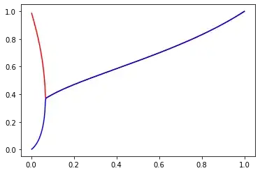

When you calculate what ${x}^{x^{x^{x\cdots }}}$ converges to between $0$ and $1$, before approximately $0.065$ the graph bifurcates.
graph image
Why does this happen and is there a reason for it happens at that number?

    A preliminary obsevation: when $x\rightarrow0$, $x^x\rightarrow1, x^{x^x}\rightarrow0,x^{x^{x^x}}\rightarrow1$, etc. So it may turn out that the sequence is "alternating." – Tesla Daybreak Mar 02 '21 at 06:16
    Maybe this will help someone else work out the details: it looks like the transition is at $e^{-e} \approx 0.065988$. When $0 < c < e^{-e}$ it appears that there's a unique positive real solution $x_0$ to $x = c^x$, but it's an unstable equilibrium point because we have $\big| \frac{d}{dx}(c^x)|_{x = x_0} \big| > 1$. – Ravi Fernando Mar 02 '21 at 06:23

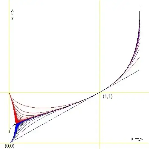

    Just curious: how did you obtain the red line? – Han de Bruijn Mar 05 '21 at 20:16
  • @HandeBruijn : take some small number $0 \lt b \lt 1/e^e$ as base, and iterate. Document each value alternatingly in a different bin, say $t_{lo}$ and $t_{hi}$. The values in the two bins converge over the iterations to individual limits. Do this for many $0 \lt b \lt 1/e^e$ and plot the two convergents for all of the chosen bases. For the $t_{lo}$ use light-blue, for the $t_{hi}$ use red for plotting... – Gottfried Helms Mar 06 '21 at 12:41
  • @GottfriedHelms: What I did was programming the power tower as $f_{k+1}(x)=x^{f_k(x)}$ for $0 \le k \lt n$, starting with $f_0(x)=x$. Then I could reproduce the blue plot of $f_n(x)$ for $n=$ even. Thanks to your comment I see now that $f_n(x)$ for $n=$ odd gives the red line. – Han de Bruijn Mar 06 '21 at 13:19
  • Is there any exact value ($\approx 0.4$) of the tower function for $x=1/e^e$? – Han de Bruijn Mar 06 '21 at 13:42
  • @HandeBruijn - if this is what you're asking: with $b=(\text{or }x=)1/e^e$ it is known that the convergent is $t_{lo}=t_{hi}=1/e$ – Gottfried Helms Mar 06 '21 at 15:12

The power tower at hand is recursively defined as: $$ h_0(x) = x \quad ; \quad h_{n+1}(x) = x^{h_n(x)} \quad ; \quad h(x) = \lim_{n\to\infty} h_n(x) $$ The recursion process is visualized in the picture below:

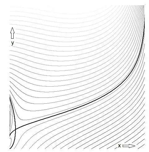

The $\color{blue}{blue\;lines}$ are the iterands for $n=$ odd; the $\color{red}{red\;lines}$ are the iterands for $n=$ even. It is seen that splitting up odd and even starts at $x\lt 1$ and that there is a bifurcation point (black dot). Going to infinity leads to the functional equation: $$ y = x^y \quad \mbox{with} \quad y = h(x) $$ The inverse function (where it exists) has an explicit analytical form, which is the black line in the above figure: $$ x = y^{1/y} $$ And can be used to establish the rightmost bound of the tower's domain: $$ \frac{d}{dy}y^{1/y} = e^{\ln(y)/y}\left[-\frac{\ln(y)}{y^2}+\frac{1}{y^2}\right] = 0 \\ \Longrightarrow \quad \ln(y)=1 \quad \Longrightarrow \quad y=e \; ; \; x=e^{1/e} $$ But in order to answer the question as stated, we have to consider another functional equation, namely: $$ y = x^{x^y} $$ Odd and even are separated now, as is required for observing the bifurcation. There is no neat inverse function of the latter equation. Therefore we shall investigate the two-dimensional funcion $\,f(x,y)=x^{x^y}-y\,$. An insightful way to do this is make an isoline chart / contour plot of the function. Lines are darker where the contour levels are higher. The massive black line is the place where $f(x,y)=0$.
Implicit differentiation is employed for finding the derivatives: $$ df = \frac{\partial f}{\partial x} dx + \frac{\partial f}{\partial y} dy \\ df = x^{x^y}\left[\frac{x^y y \ln(x)}{x} + \frac{x^y}{x}\right] dx + \left[x^{x^y}x^y\ln^2(x)-1\right] dy $$ If the gradient is zero, then $f(x,y)$ has a critical point at that place: $$ \begin{cases} \partial f/\partial x = 0 & y \ln(x)+1 = 0 \\ \partial f/\partial y = 0 & x^{x^y}x^y\ln^2(x)-1=0 \end{cases} $$ Both equations are essentially the same, because $\,x^{x^y}=x^y=y\,$, giving with $\,x=y^{1/y}\,$: $$ y \ln(y^{1/y})+1 = \ln(y)+1 = 0 \quad \Longrightarrow \quad y = 1/e \quad ; \quad x = e^{-e} $$ If we look at the picture with the isolines, then it is evident that the bifurcation must be at this place, with coordinates $\,(x,y)=(e^{-e},1/e)\,$.

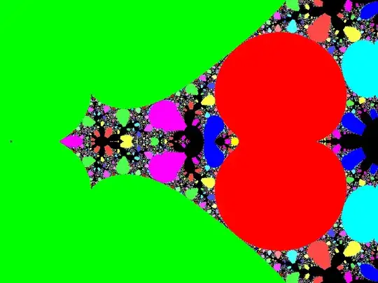

  • @HandeBrujin $x^{x^y}x^y\ln^2(x)=1$ does not look like the boundary, in green in the link, of where the bifurcation converges. Do you know the equation for it? – Тyma Gaidash Mar 11 '23 at 02:05
See Projective Fractals for an explanation of why the bifurcation is at $e^{e^{2 \pi i x-{e^{2 \pi i x}}}}$ where $x=-1$. tetration Mandelbrot fractal
