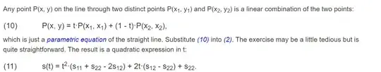

I don't get what exactly is the quantity benig plugged into (1) is, it seem the point has arguement $P(x_1,x_1)$ which doesn't make sense to me. I think the correct expression should be :
$$ P(x,y)= tP(x_1,y_1) + (1-t)P(x_2,y_2)$$
Hence the point being plugged in is given as:
$$ Q = (tx_1 + (1-t)x_2 , ty_1 + (1-t)y_2) $$
However, this seems to be still algebra bashing to move from (10) to (11), is there a more elegant approach to it?
