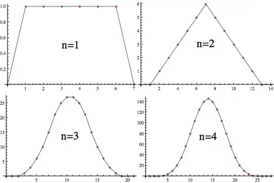

Summing Dice
Perhaps one of the earliest uses of convolution was in probability. If $f_n(k)$ is the number of ways to roll a $k$ on $n$ six-sided dice, then $$ f_n(k)=\sum_jf_{n-1}(k-j)f_1(j)\tag{7} $$ That is, for each way to achieve $k$ on $n$ dice, we must have $k-j$ on $n-1$ dice and $j$ on the remaining die. Equation $(7)$ represents discrete convolution.
The distribution function for the roll of a single six-sided die is evenly distributed among $6$ possibilities. This has discontinuities at $1$ and $6$ ($n=1$). The distribution function for the sum of two six-sided dice is the convolution of two of the one die distributions. This is continuous, but not smooth ($n=2$). The distribution function for the sum of three six-sided dice is the convolution of the one die and two dice distributions. This is smooth ($n=3$). For each die we add, we convolve one more of the one die distributions and the function gets smoother.
$\hspace{8mm}$enter image description here
As $n\to\infty$, the distribution approaches a scaled version of the normal distribution: $\frac1{\sqrt{2\pi}}e^{-x^2/2}$.
