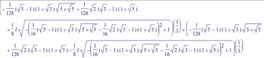

This will be my attempt at answering your question about finding $\sin(\frac{143°}{3})=\sin(\frac x3)$.
Let θ=$\frac x3$ and using this website
$\sin(3θ)=3\sinθ-4\sin^3θ$ Therefore, we need to solve this equation for sin(θ):
$4\sin^3θ-3\sinθ+ \sin(3θ)=0⇔ \sin^3θ -\frac 34 \sinθ+ \frac 14 \sin(3θ)=0$
Using Cardano’s Depressed Cubic Formula gets us the first root of the cubic equation gets us:
$\sqrt[3]{ \frac {-q}{2}+\sqrt{\frac{q^2}{4}+\frac{p^3}{27}}}$+ $\sqrt[3]{ \frac {-q}{2}-\sqrt{\frac{q^2}{4}+\frac{p^3}{27}}}$ where q=$\frac 14 \sin(3θ)$= $\frac 14 \sin(x)$= $\frac 14 \sin(143°)$= $\frac 14 \sin(37°)$ which is the constant value of the equation and p=-$\frac 34$ which is the coefficient of the linear value of degree one in the equation above.
Plug these into the formula and simplify to get an answer. We will use the fact that $\sin143°=\sin37°$:
$\sqrt[3]{ \frac {-(1/4)\sin37°}{2}+\sqrt{\frac{((1/4)\sin37°)^2}{4}+\frac{(-3/4)^3}{27}}}$+ $\sqrt[3]{ \frac {-1/4)\sin37°}{2}-\sqrt{\frac{((1/4)\sin37°)^2}{4}+\frac{(-3/4)^3}{27}}}$=
$\sqrt[3]{ \frac {-\sin37°}{8}+\frac 18 \sqrt{\sin^2 37°-1}}$+$\sqrt[3]{ \frac {-\sin37°}{8}-\frac 18 \sqrt{\sin^2 37°-1}}$=$\frac 12 (\sqrt[3]{i\cos37°- \sin37°}-\sqrt[3]{\sin37°+i\cos37°})$.
Unfortunately, $\sin37°=\cos53°$ and $\cos37°=\sin53°$ do not have easily solvable forms, but this website has the exact values for sine. However, $\sin37°=\sin143°=\sin\frac{37π}{180}$ so here are the steps for finding this value:
1.Use the same technique but sin(5θ)=sinx,x=π. Then, $θ=\frac {x}{5}$ and using the multiple angle formulas for sin in the above website to get sinπ=0=$5y-20y^3-16y^6$,and solve for $y=\sinθ=\sin\frac π5$
2.Use the cubic technique on $sin\frac π5$ to get $\sin\frac{π}{15}$
3.Use the half angle formula twice to get $\sin\frac{π}{60}$
4.Use the cubic technique again on $sin\frac π{60}$ to get $\sin\frac{π}{180}$
5.Finally use the multiple angle formula for $\sin(37a)=\sin\frac{37π}{180}$
6.Evaluate $\sqrt{1-\sin^2\frac{37π}{180}}$= $\cos\frac{37π}{180}$
This means the final answer is: $\sin\frac{143°}{3}$= $\frac 12 \bigg(\sqrt[3]{\bigg[}\bigg($[$\bigg)i-\bigg($ enter image description here$\bigg)-\sqrt[3]{\bigg[}$enter image description here$+\bigg($enter image description here$\bigg)i\bigg]\bigg)$
Here is proof of my answer. Please correct me if I am wrong or give me feedback!
