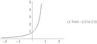

The plot of this would look like (for the main branch):
Gamma[1.5] (1/(1 - x)^1.5) by Wolfram|Alpha
And the function of the main branch would be: $$\fbox{$ \begin{align*} \operatorname{D_{x}^{\frac{1}{2}}}\left[ \frac{1}{1 - x} \right] &= \Gamma\left( 1.5 \right) \cdot \left| \frac{1}{\left( 1 - x \right)^{1.5}} \right|,\, \text{for}\, x \in \mathbb{R}_{< 1}\\ \end{align*} $} \tag{3}$$
If we insert $x = 0$ we get: $$ \begin{align*} &= \pm\Gamma\left( 1.5 \right) \cdot \frac{1}{\left( 1 - 0 \right)^{1.5}}\\ &= \pm\Gamma\left( 1.5 \right) \cdot \frac{1}{\left( 1 \right)^{1.5}}\\ &= \pm\Gamma\left( 1.5 \right) \cdot \frac{1}{\pm 1}\\ &= \pm\Gamma\left( 1.5 \right) \cdot \pm\frac{1}{1}\\ &= \pm\Gamma\left( 1.5 \right)\\ &= \pm\frac{1}{2} \cdot \sqrt{\pi}\\ \end{align*} $$
I got the exact value of the Complete Gamma Function form Wikipedia. Note: Both $\pm$ are independent of each other and $\frac{1}{2} \cdot \sqrt{\pi}$ would be the main branch.

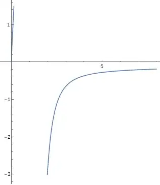

Calculation Via Series Expansion
Another well-known and frequently used method to differentiate a function fractionally is simply to differentiate the series expansion of this function with addends from functions that are easier to differentiate fractionally.
$\frac{1}{1 - x}$ has a nice series expansion given by $$ \begin{align*} \frac{1}{1 - x} = 1 + \sum\limits_{k = 1}^{\infty}\left[ x^{k} \right]. \end{align*} $$
If we now apply the Formula $\left( 1 \right)$ where $a = 1 ~\wedge~ b = 0 ~\wedge~ c = k$ to it (this is a spezial case sometimes called "Euler's Fractional Derivative of Monomials", we would get this: $$ \begin{align*} \operatorname{D_{x}^{\alpha}}\left[ \frac{1}{1 - x} \right] = \operatorname{D_{x}^{\alpha}}\left[ 1 + \sum\limits_{k = 1}^{\infty}\left[ x^{k} \right] \right]\\ \operatorname{D_{x}^{\alpha}}\left[ \frac{1}{1 - x} \right] = \operatorname{D_{x}^{\alpha}}\left[ 1 \right] + \operatorname{D_{x}^{\alpha}}\left[ \sum\limits_{k = 1}^{\infty}\left[ x^{k} \right] \right]\\ \operatorname{D_{x}^{\alpha}}\left[ \frac{1}{1 - x} \right] = \operatorname{D_{x}^{\alpha}}\left[ 1 \right] + \sum\limits_{k = 1}^{\infty}\left[ \operatorname{D_{x}^{\alpha}}\left[ x^{k} \right] \right]\\ \operatorname{D_{x}^{\alpha}}\left[ \frac{1}{1 - x} \right] = \operatorname{D_{x}^{\alpha}}\left[ 1 \right] + \sum\limits_{k = 1}^{\infty}\left[ 1^{\alpha} \cdot \frac{\Gamma\left( k + 1 \right)}{\Gamma\left( k - \alpha + 1 \right)} \cdot \left( 1 \cdot x + 0 \right)^{k - \alpha} \right]\\ \operatorname{D_{x}^{\alpha}}\left[ \frac{1}{1 - x} \right] = \operatorname{D_{x}^{\alpha}}\left[ 1 \right] + \sum\limits_{k = 1}^{\infty}\left[ \frac{\Gamma\left( k + 1 \right)}{\Gamma\left( k - \alpha + 1 \right)} \cdot x^{k - \alpha} \right]\\ \end{align*} $$
Now only the Fractional Derivative of a constant is missing. The problem: the Fractional Derivative of a constant differs immensely depending on the definition of the differential operator. I mostly use the definition $\operatorname{D_{x}^{\alpha}}\left[ \text{constant} \right] = 0$. However, a better definition would be $\operatorname{D_{x}^{\alpha}}\left[ \text{constant} \right] = \begin{cases} 0,\, &\text{if}\, \alpha \geq 0\\ \sum\limits_{k = 1}^{\left\lfloor \left| \alpha \right| \right\rfloor}\left[ c_{k} \cdot x^{k} \right],\, &\text{if}\, \alpha < 0 \end{cases}$ where $\left\lfloor \cdot \right\rfloor$ is the Floor Function also called the Greatest Integer Function or Integer Value, since this also applies to $\alpha \in \mathbb{R}^{-}$ and can therefore be used for indefinite integrals. Using this would give us: $$ \begin{equation*} \operatorname{D_{x}^{\alpha}}\left[ \frac{1}{1 - x} \right] = \operatorname{D_{x}^{\alpha}}\left[ 1 \right] + \sum\limits_{k = 1}^{\infty}\left[ \frac{\Gamma\left( k + 1 \right)}{\Gamma\left( k - \alpha + 1 \right)} \cdot x^{k - \alpha} \right]\\ \operatorname{D_{x}^{\alpha}}\left[ \frac{1}{1 - x} \right] = 0 + \sum\limits_{k = 1}^{\infty}\left[ \frac{\Gamma\left( k + 1 \right)}{\Gamma\left( k - \alpha + 1 \right)} \cdot x^{k - \alpha} \right]\\ \operatorname{D_{x}^{\alpha}}\left[ \frac{1}{1 - x} \right] = \sum\limits_{k = 1}^{\infty}\left[ \frac{\Gamma\left( k + 1 \right)}{\Gamma\left( k - \alpha + 1 \right)} \cdot x^{k - \alpha} \right]\\ \end{equation*} $$
$$\fbox{$ \begin{align*} \operatorname{D_{x}^{\alpha}}\left[ \frac{1}{1 - x} \right] = \sum\limits_{k = 1}^{\infty}\left[ \frac{\Gamma\left( k + 1 \right)}{\Gamma\left( k - \alpha + 1 \right)} \cdot x^{k - \alpha} \right]\\ \end{align*} $} \tag{4}$$
A Plot of the it for $\alpha = \frac{1}{2}$ looks like:
Sum[Gamma(k + 1)/Gamma(k - 0.5 + 1) x^(k - 0.5),{k,1,[Infinity]}
This function has exactly one branch. if we plug $x = 0$ and $\alpha = \frac{1}{2}$ in, we will get: $$ \begin{align*} &= \sum\limits_{k = 1}^{\infty}\left[ \frac{\Gamma\left( k + 1 \right)}{\Gamma\left( k - 0.5 + 1 \right)} \cdot 0^{k - \alpha} \right]\\ &= \sum\limits_{k = 1}^{\infty}\left[ \frac{\Gamma\left( k + 1 \right)}{\Gamma\left( k + 0.5 \right)} \cdot 0 \right]\\ &= \sum\limits_{k = 1}^{\infty}\left[ 0 \right]\\ &= 0\\ \end{align*} $$
