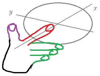

Criterion A for Orientation of Boundary Curve (from Stewart p. 1093):
If you walk in the positive direction around $\partial S$ and your head points in the direction of $\mathbf{\hat{n}}$, then the surface will always be on your left.
Criterion B (from Thomas' Calculus, 2009 12 edn, p 963):
If the thumb of a right hand points along $\mathbf{\hat{n}}$, then the fingers curl in the direction of $\partial S$.

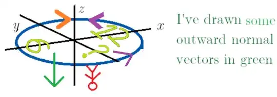

I know that the orientation of $S$ determines the positive orientation of $\partial S$. Also, the outward unit normals determine any closed surface's positive orientation . Here, the outward unit normals have $z$-component $< 0$ which yields the person in red.
$\color{purple}{\text{By Criterion A, the red person's head is pointing downwards (in the $-z$ direction)}}.$
$\color{purple}{\text{The purple direction is compulsory for the surface to be on that person's left.}}$
By Criterion B, my thumb must point in the $-z$ direction. So my fingers curl in the orange direction.
Why's there a discrepancy between Criteria A and B? Where's the mistake?

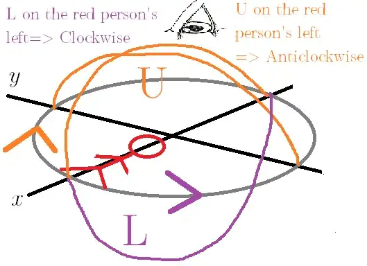

Here's my interpretation: The red person must travel in the purple direction, for the surface to be on her left. Then the purple direction is counterclockwise when viewed from above the $xy$-plane, BUT when viewed from below (as the red person is doing), the purple direction is CLOCKwise.
I had to draw a clock in my updated picture to spot this. Without this clock, I still don't understand why the purple direction can be both clockwise and counterclockwise, depending on from where I look at ahe $xy$-plane. Is there a more intuitive or natural explanation, without drawing clocks?

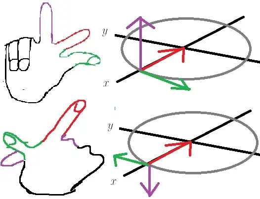

I still don't understand how to spot that reflections across the $xy$-plane reserve orientation (but preserve direction), without looking at a sheet of paper from above and below.
$\Large{1.}$ Why did you choose the basis {$j, -i, k$}, instead of the standard basis for $\mathbb{R}^3$?
$\Large{2.}$ Doesn't $-i := (-1,0,0)$ imply that the tip of the vector, lying on the $x$-axis, point towards $-\infty.$ How does it "still point inward"?
