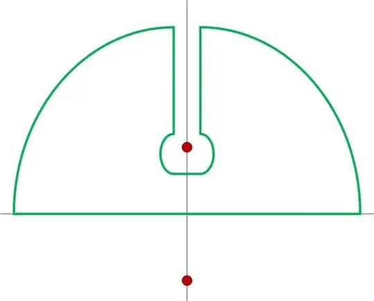

To evaluate the first integral above, we consider the integral in the complex plane
$$\oint_C dz \frac{\log{(1+z^2)}}{1+z^2}$$
where $C$ is some contour to be determined. Our first instinct is to make $C$ a simple semicircle in the upper half plane. The problem is that the branch point singularity at $z=i$ is extremely problematic, as it coincides with an ostensible pole. Nonetheless, the corresponding integral over the real line is finite (and twice the originally specified integral), so there must be a way to treat this.
The way to go with branch points like this is to avoid them. We thus have to draw $C$ so as to do that, and then use Cauchy's theorem to state that the above complex integral about $C$ is zero. Such a contour $C$ is illustrated below.
contour
The contour integral is then taken along six different segments. I will state without proof that the integral about the two outer arcs vanishes as the radius of those arcs $R \to \infty$. We are then left with four integrals:
$$\int_{-R}^R dx \frac{\log{(1+x^2)}}{1+x^2} + \left [\int_{C_-}+\int_{C_+}+\int_{C_{\epsilon}} \right ] dz \frac{\log{(1+z^2)}}{1+z^2} = 0$$
$C_-$ is the segment to the right of the imaginary axis, down from the arc to the branch point, $C_+$ is the segment to the left of the imaginary axis, up from the branch point to the arc, and $C_{\epsilon}$ is the circle about the branch point of radius $\epsilon$.
It is crucial that we get the arguments of the log correct along each path. I note that the segment $C_-$ is "below" the imaginary axis and I assign the phase of this segment to be $2 \pi$, while I assign the phase of the segment $C_+$ to be $0$.

I note that the sum of the integrals along $C_-$ and $C_+$ is
$$-2 \pi \int_{\epsilon}^R \frac{dy}{y (2+y)} = -\pi \left [ \log{R} - \log{(2 + R)} - \log{\epsilon} + \log{(2 + \epsilon)}\right]$$
For the segment $C_{\epsilon}$, set $z=i (1+\epsilon e^{-i \phi})$. The integral along this segment is
$$\begin{align}\int_{C_{\epsilon}} dz \frac{\log{(1+z^2)}}{1+z^2} &= \epsilon \int_{-2 \pi}^0 d\phi e^{-i \phi} \frac{\log{\left [ -2 \epsilon e^{-i \phi} \right]}}{-2 \epsilon e^{-i \phi}}\end{align}$$
Here we use $\log{(-1)}=-i \pi$ and the above integral becomes
$$\begin{align}\int_{C_{\epsilon}} dz \frac{\log{(1+z^2)}}{1+z^2} &= -\frac12 (-i \pi)(2 \pi) - \frac12 \log{2} (2 \pi) - \frac12 \log{\epsilon} (2 \pi) -\frac12 (-i) \frac12 (0-4 \pi^2) \\ &= -\pi \log{2} - \pi \log{\epsilon} \end{align}$$
